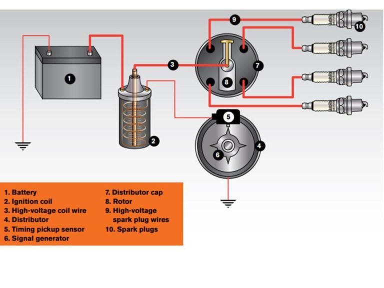

Posts: 16398
PostPosted: Sun Jun 24, 2018 9:10 pm    Post subject: Reply with quote
Magneto vs Distributor
Quote:
An ignition magneto, or high tension magneto, is a magneto that provides current for the ignition system of a spark-ignition engine, such as a petrol engine. It produces pulses of high voltage for the spark plugs. The older term tension means voltage.[1]
The use of ignition magnetos is now confined mainly to engines where there is no other available electrical supply, for example in lawnmowers and chainsaws. It is also widely used in aviation piston engines even though an electrical supply is usually available. In this case the magneto's self-powered operation is considered to offer increased reliability; in theory the magneto should continue operation as long as the engine is turning.
In short the magneto produces it's own electrical power for the ignition system.
This is an automotive Magneto for a small block Chevy
This is a Magneto on an Allis Chalmers Tractor.
These have rotating magnets internally that generate the spark.
__________________________________________________________
Quote:
Battery and coil-operated ignition system with distributors.
Main article: Inductive discharge ignition
With the universal adoption of electrical starting for automobiles, and the availability of a large battery to provide a constant source of electricity, magneto systems were abandoned for systems which interrupted current at battery voltage, using an ignition coil to step the voltage up to the needs of the ignition, and a distributor to route the ensuing pulse to the correct spark plug at the correct time.
An improved ignition system was developed by the Dayton Engineering Laboratories Co. (Delco) and introduced in the 1910 Cadillac. This ignition was developed by Charles Kettering and was a wonder in its day. It consisted of a single ignition coil, points (the switch), a capacitor (to prevent the points from arcing at break) and a distributor (to direct the spark from the ignition coil to the correct cylinder).
This is a battery powered distributor type auto ignition system.
Here you can see the automotive battery powered distibutor ignition system and the inside of the distributor. Note there are no internal magnets in a distributor.
This is the IAU4006AUT DISTRIBUTOR
This is NOT a magneto.
Finally for those that are still not convinced that black spark maker in the M38 is actually a distributor:
Even the Military admitted they were in fact DISTRIBUTORS
