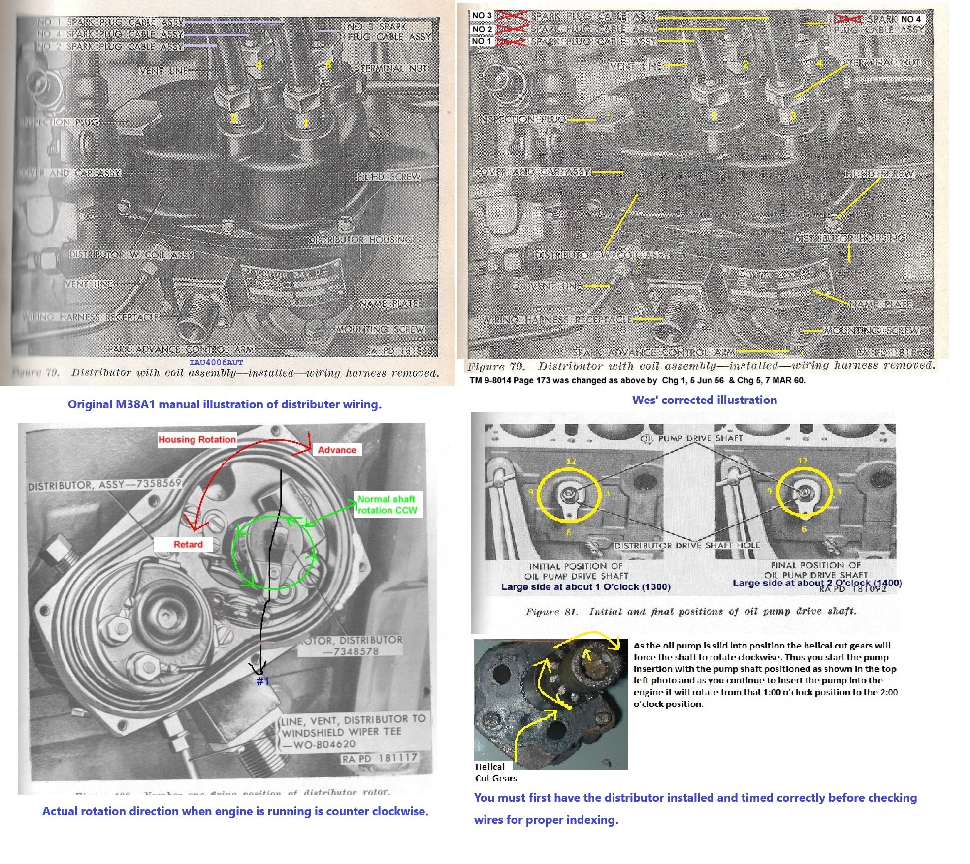

i have realized that the ignition was wired wrong according to manual ( corrected version)
it should be from bottom right counter clockwise 1342 , but on mine it is 1234 ( i consider cylinder 1 to be the one forward, fan side and 4 in the back)
yes it starts and run with this wrong firing order
when i revert to what it should be no ignition at all
makes no sense for me, before i dig down further and check all positions i was curious to hear some experts comments on this - how can it start and why would the previous guy to this ? best from Denmark, Mehdi
The manual illustration was originally in error. I corrected it here on my site with my own illustration showing the correct alignment. Both illustrations show the correct firing order, 1-3-4-2 and correct counter-clockwise rotation of the rotor. The actual issue is where we put the wires in the cap. The old illustration shows #1 lower right and the corrected illustration shows #1 lower left.
The wrong setup actually works if the distributor was timed to the engine using that lower right position for #1.
If when you switched the wires around she wouldn't start then the distributor was timed to the engine with #1 lower right. and will only run with the wrong wire indexing.
You have two options.
1 - Return the wires to the way they were when she was running rough. Then re-adjust timing as needed to get the timing at the correct timing mark.
2 - Keep the wires in their new index positions and remove the distributor and re-time the distributor to the engine.
The problem that prompted the correction to the wire indexing was with the #1 indexed to the lower right the distributor housing often hits the block when trying to set it's advance timing correctly before it could reach the proper position.
