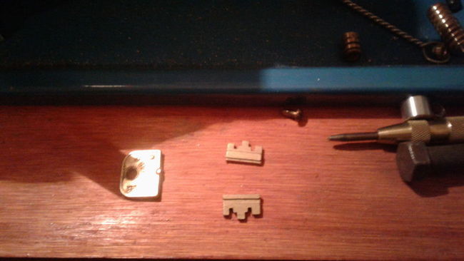

I did a test with the lathe for turning the pins today.
Use the shaft of a old key.
The results are good !
