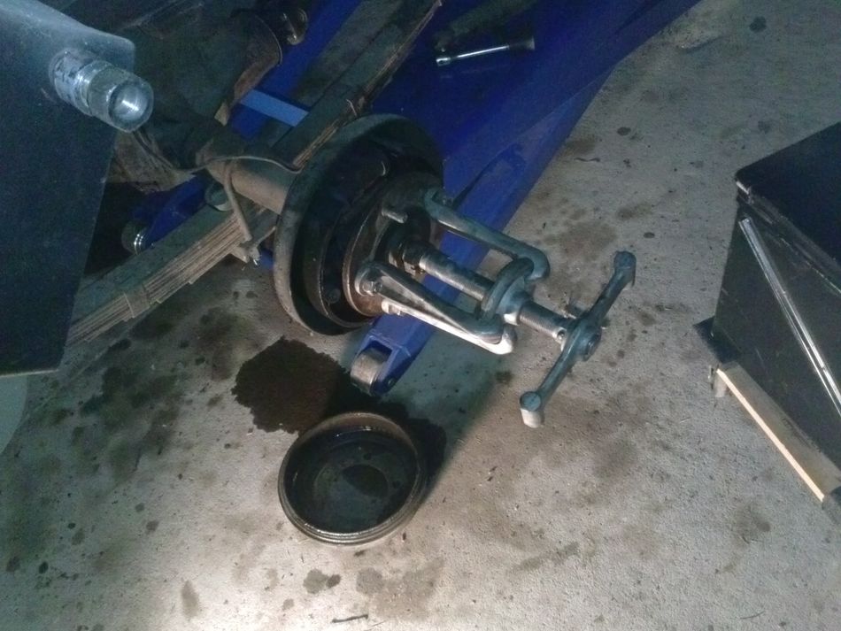

I pulled one of my rear wheels today and discovered the brake backing plate has a good sized split in the bottom plus it is twisted. Read up on it and it does not appear too difficult to disassemble just need a puller to pull the hub and drum from the shaft. Anything else to be aware of? Thanks all.
Posts: 16247
PostPosted: Mon Aug 06, 2018 10:46 pm    Post subject: Reply with quote
I moved your post from "Photo Albums requests and Album Issues" to this "Technical Knowledge Base Board".
You may get lucky if the last guy that put the rear hub/drum on used some Anti-Seize. So loosen the nut and smack the drum with a large ballpean hammer and if it pops loose just press on and follow the steps in the manual.
If it doesn't pop loose then you will need to find a proper puller:
The preferred puller:

Is that puller jeep specific? Where would I find one if I end up needing it?
Posts: 16247
PostPosted: Tue Aug 07, 2018 6:29 pm    Post subject: Reply with quote
Just google striker type hub puller. It's a common industry puller. They are not cheap. Might want to hit your local tool renting shop first. Or even Ebay. I often see gove surplus ones on there reasonable.
O'Reilly carry's them for $159.
