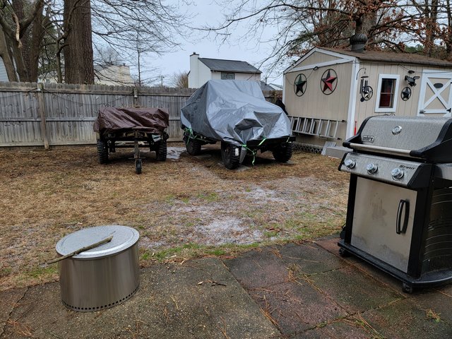

Posted: Fri Jan 21, 2022 3:42 pm Post subject: |
Still waiting on my gear from RFJP which I ordered on Monday. Was supposed to be delivered here today in VA, but I am sure the weather across the country isn't helping.
Here is the major snow storm we got yesterday...
Actually weird the back yard has none- and the front has about an inch.
