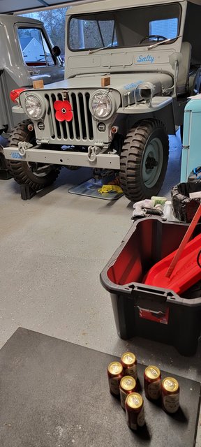

To get the jeep out of my yard, I have to drive thru a fence with only 2" to spare total. Made it
Parked out front,
Backyard looks so empty!
Did a quick shake down. Couldn't get into second gear, but maybe I just wasn't going fast enough?
Sprung a oil leak on the fitting I repaired this morning.
Will fix it again.
Tight fit!! And I never noticed, I have a port side list.
I'm out of parking spaces! Need to upgrade this house or take up a different hobby; like marksmanship and maybe nylint toy car refurbishment.
More to come. I'm exhausted- I moved 5 yards of muddy dirt I to the back yard to help repair my messed up yard. _________________ April

Looking at your list. I thought the garage photo showed the list aft of the engine. The front of the hood and bumper look horizontal. Looked at the gate photo again. Have the same impression.
Sure looks like a mount issue or interference between the cowl and frame mount.
How does the rear of the tub look in relation to the rear crossmember. Is it localized to the area of the cowl/windshield?
