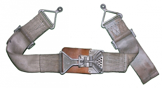

I'm trying to keep my Air Force-marked M38A1 stock, but I wanted seatbelts.
Aftermarket seat belts weren't common when M38A1s were new, so I asked myself "what would an Air Base do if the local regs mandated seatbelts?"
My dad was in the Air Force, as a kid I remember that ALL privately owned cars on base had to be retrofitted with seatbelts, circa 1963-65...long before the federal laws came into effect for the '68 model year. Then, you could take your car to the on base Texaco for installation or go to Western Auto off base, but in the period when my Jeep was new (it's a '55), I'm guessing aftermarket seat belts weren't common.
So I figured if some safety-minded Wing/Group/base commander wanted seatbelts in military vehicles, they would get aircraft style seat belts from base supply. Mine is marked as a vehicle with the Troop Carrier unit (today it would be called an Airlift Wing) my father flew with when I was born and the Jeep was new, so the base motor pool would have aircraft passenger seatbelts available.
I'm into antique aircraft and warbirds, friends gave me old units which I sent to an aviation parts supply house for overhaul with cleaned up metal and new webbing. The refurbishment cost was only $200 for both. Now you can get generic modern push button belts for less, but they would have looked out of place in an open vintage Jeep.
The belts themselves look like this...(before overhaul)...
https://www.bellsaviationmuseum.org/fh_item_photos/Image_0807_205_600_540x295.jpg
Anyway, just an idea for period looking belts.
