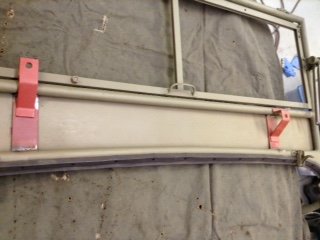

I know this has been asked before, but, I can't find it now. Is the dash mounted rifle bracket the same for the WWII jeep and the M38 or M38A1? Thanks.

The WWII brackets are:
A11581
A11584
A11945
M38 are:
673395
673394
673380
M38A1 didn't use the windshield brackets. Most folks use the standard M series vertical dash mount with the floor but stock socket.
A11581
A11584
A11945
M38 are:
673395
673394
673380

The rifle rack is the same WWII & M38 but not M38A1. The mounting brackets differ a bit.
WWII 45 MB
M38 right
M38 left & left end brackets.
WWII 45 MB
M38 right

That's a good question for John bizal?
