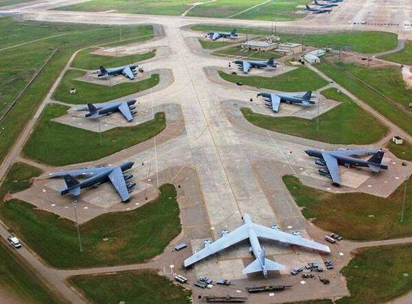

When I was pulling alert duty there in the 70's we kept 8 G's on the tree and 4 soft alert G's on sites 1 thru 4 (you can see sites 1, 2 & 3 at the upper right of the above photo). Then we kept 8 KC's on the north ramp across from those first 4 sites. We also had 4 buffs satellite alert at Shepherd AFB and two Tankers on satellite alert at Blytheville.
Posts: 2065
I'm guessing that post and photo have been declassified....... 8O....only a few H's flying nowadays, and I believe we let everybody and their brother with a satellite camera fly over anyway..... :D...nice photo!

After 40 years...I would hope so.

Nice photo Wes!! I spent 35 days in the building on the Christmas tree during Hurricane Katrina. We parked the semi's with supplies on the tree and the two trailers to the right was where the truckers took their showers.
I did get to go inside where the B52s were once serviced and seen the remains of a bygone era!! The extra heavy duty phone on the wall really showed its age!!
I will note that there were signs posted stating that no filming or counting of planes was allowed---I even seen one trucker and his wife get picked up for filming the base and they did not return.

A heartbreaking look after seeing the above photo...
Google Earth or other sat or aerial site to Davis-Montham AFB outside
Tucson.
I guess to show the Reds we demobed the nuke capable Buffs they
just cut the front section off the fuselage.
Makes me sick.
