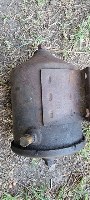

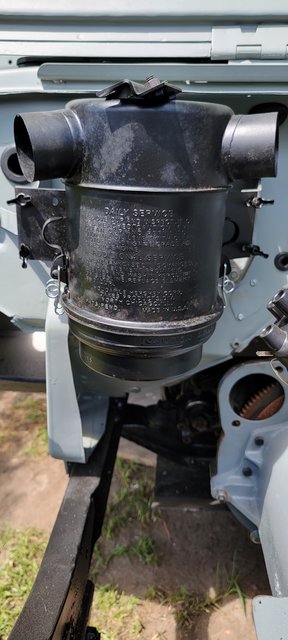

Side quest.
Which side does the extension piece go on? passenger or driver?
It's not installed on this one as it is pictured
I was looking around in peoples photo albums and didn't see. My jeep did not have any of this when I bought it.

The extension bracket for the air cleaner goes on the drivers side, and it's positioned to hold the filter body further out and away from the firewall. The slotted mounting holes on that bracket mate to the firewall-mounted bracket with two "special" wing-bolts" (+2 more wing-bolts on the passenger side). The round holes use regular hex bolts to the body.
I think the Army's idea with the wing-bolts was that no tool would be required to remove and clean-service the air cleaner by the average driver-soldier. Except they forgot about the vacuum lines at the top.
Figure 49 on page 165 of TM9-8012 is the best shot I could find in the manuals. It shows the cleaner mounted and the bracket isn't on the passenger side.
Hope this helps.
