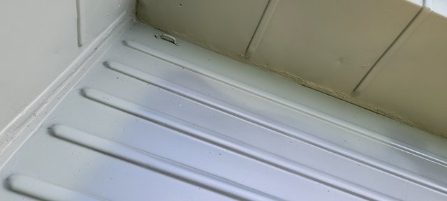

Today I put it in another coat of epoxy early this AM.
By afternoon, I was coating in lusterless grey just like my jeep.
Here you can see the difference in the grey epoxy vus the lusterless.
Lusterless has more of a greenish tint to it. This is only way I ever can tell. I was not blessed with the woman skill of determining different shades of color!

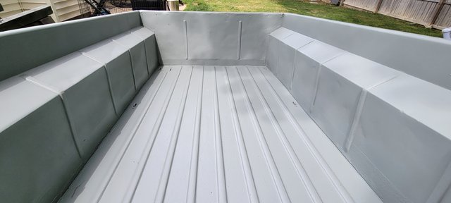

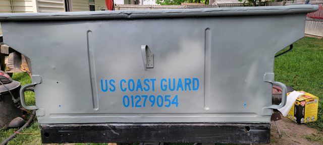

Not everyone's cup of tea, but I put truck bed liner in.
Put top coar of lusterless on.
Touch up on frame paint done.

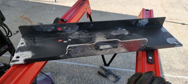

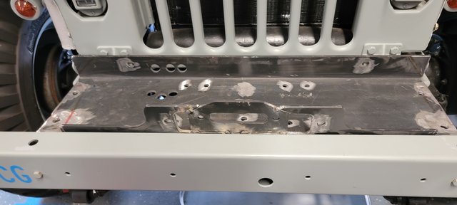

messing with the winch plate. It's designed for a larger type winch. I just bought a universal winch plate and it filled the gap on the front frame very well.
Modifying the fairlead from the large one down to the smaller. This is a 5500 lb winch. Thr cashier at HF gave me a 25% discount on it- not sure why- maybe he was sweet on me and I had no clue.
Still a little smoothing out to do. I do intend to fill the unused holes on the plate today.
Not much left to tinker with on the jeep as it is now. Time to start putting miles on it.
Finished welding the holes up, I did paint it black, but didn't get a photo.

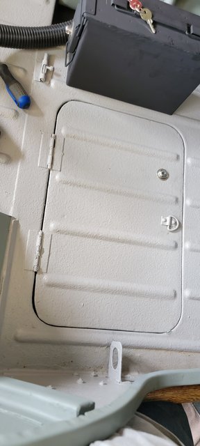

I installed a small lock on the tool box. Not overly secure, you can bend if you give it a hard pull, but I put it on anyway. He'll a dumb dumb probably couldn't figure out how to raise the seat with the barrel lock on.

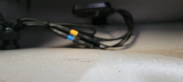

Not that some would care for what I did. I put a motorcycle dash cam (waterproof front and rear cameras) on the jeep. The dvr is in the tool box ( it's also water proof)
I can pull the images up on my phone and save video or photos.
With the view of the toolbox, the dvr is well hidden.

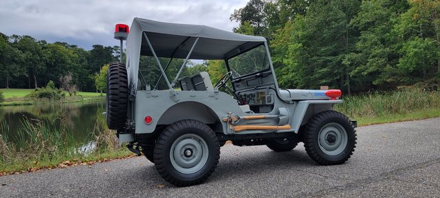

Took Salty out to the local park for a quick drive/shakedown longer than a mile. I spent about 10 miles driving through the park (which turns into a golf course).
I've got a brake leak at the master cylinder brake light and have to get that heat shield to get to it. That is a future me problem as I am down to only 3 weekends left before I move to Hawaii till April. I may dig in next weekend though- I have a lot of deployment preps to do.

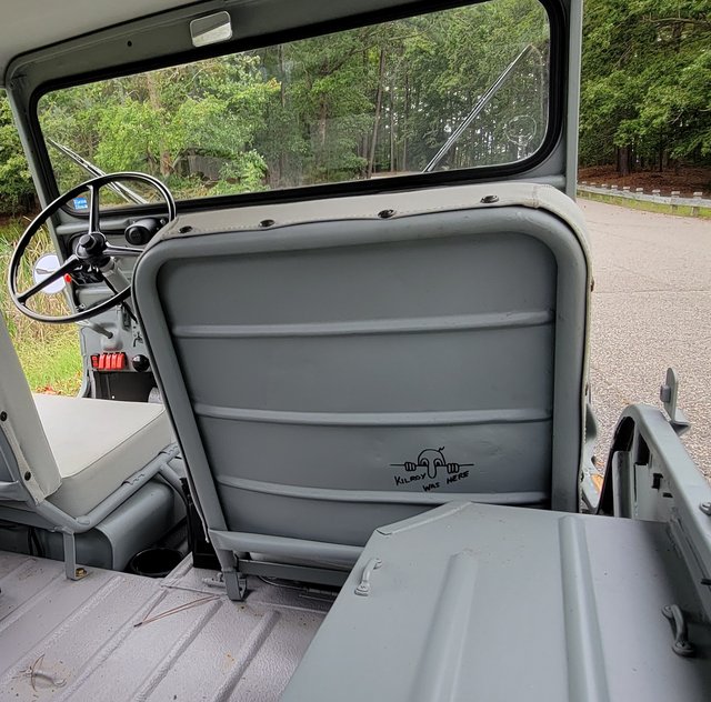

The story behind this= and I will change the sticker soon.
My Grandpa Doug used to work at a shipyard in Boston just before WW2. He was considered an essential worker and was not allowed to go join the USAAF like he wanted to. Finally, in 1943 he was allowed and went on to be a Navigator on B-24's. While he was in the Air Force, and when he came back to the shipyard after the war, he used to write "Doug was here" on everything. He was 21=24 during his service.
