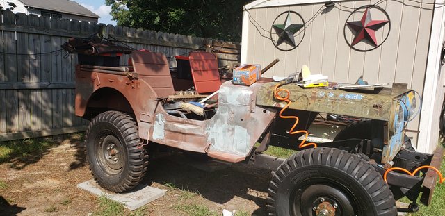

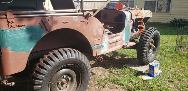

It was stupid hot out and I should probably have waited, but I used 40 grit, sanded the areas I think needed some short strand and started applying.
I am not going to make this body super straight because I’d never drive it then. A few dents will be fine.

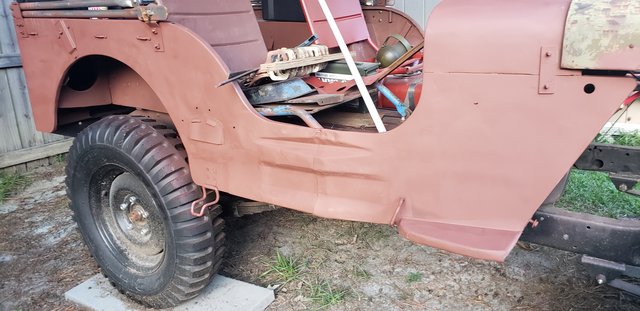

Still needed to sand more.
Back in a little red oxide.

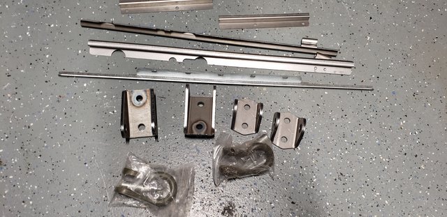

You project is looking good. You mentioned in a previous post a "hood drip rail thing that goes under the hood hinge".
I confess my ignorance. What does it look like and can you post a picture of it and where it goes on the hood hinge.
Thanks
Ralph
I think it's the bottom long piece in the photo above, directly above the rear lifting shackle brackets. Don't have one myself. I heard they don't work so good.
Here's one for sale on fleabay https://www.ebay.com/itm/173884306675?h ... SwdeFcmTkw
Posts: 16447
RG,
I did a wee bit of research and found none of my photo collections shows any hood hinge drip rails and the ORD 9 does not show one under the Hood or tub. Found nothing about it in the TBO's, MWO's and etc either.
Must be a aftermarket, civvy or bubba thingy.
Thanks Wes, I had looked in the ord9 and couldn't find anything. I am like you, I wonder if it was a cj thing or maybe a MB or GPW before the water Proof plug wires.
Yes it is a city aftermarket thing. I originally saw it on debellas page. The previous owner had an aluminum plate riveted to the cowl for this purpose of keeping water off the cylinder head.

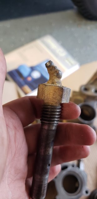

The zirc looks crusty. Wonder if it will work.
Pumped it with some grease- it was fine.

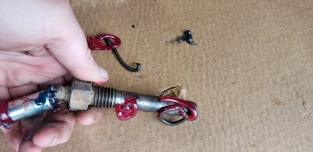

I even cleaned the reserve fuel container - Jerry Can out, derust, dried out and used Red Kote inside it, sure smelled good like cancer causing agents.
The red kote did awesome and is already dry.
I bought one of those drip rails also for my driver.
Haven’t figured out how it’s going to work with the fording cable bracket…

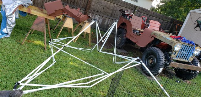

Storm yesterday took my HF sun shade down. The rain was too much and toppled it. I had the legs tied down cause I’ve had one go fly over the back fence in our summer pop up storms last year. I had to get a cut off wheel and chop this up. Saved the canopy cover for quick tarping .

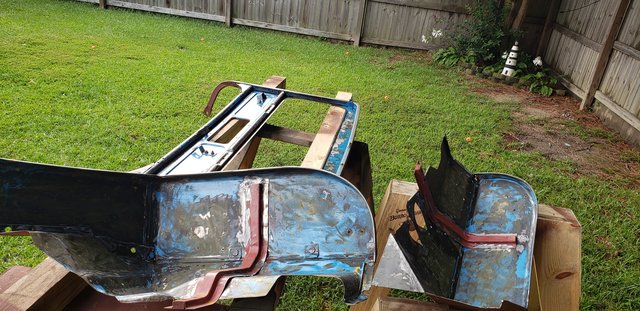

It was so much from yesterdays storm the ground was still soft. I guess by about 10am, I started digging rust out of the windshield inside frame, and also the under side of the fenders. I got what I could with wire brushes, wire wheels and disks. Ospho is working on the rust.
I need to sand more on the inner fenders. That paint is so hard to get off. The yellow and blue paint will flake off, that’s why I am trying to get it off. I can scuff the green pretty good and respray my grey lusterless on that. Just that yellow and blue is bad.
I am glad I went back outside after dinner and used that sunshade to tarp my fenders and windshield. Another nasty storm just rolled in. Weather report said 0% change of precipitation for a few more hours.

Jumping in late on the under hood drip rail: I got one last year and tried to install it earlier this Spring. I couldn't install it without taking the hood off. When I went to reinstall it didn't fit right. I've decided to leave it off in the end....
Knowing, from Wes's research, that they aren't an original issue item is great. Given that the jeep was designed to be able to submerge, who cares about the drip rail?! :-)
I think it's an interesting item to add on but given how my jeep's tweaked it didn't fit and work.
