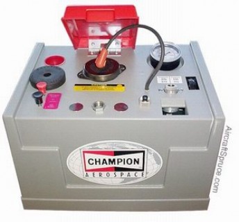

I think your mechanic calls a plug fouled when it is only saturated with gas. Normally in this industry a fouled plug is fouled with lead deposits or oil. A wet plug is one that has been saturated in gas.
Wet or fouled does not condemn a plug. You clean and dry it, ohm check it and if at all possible put it in a spark plug tester and fire the plug. You said they were a new set of plugs. Did you gap them????? before installation?
I have 3 of these. One in my garage and one in my hangar shop and a spare one. It takes two minutes to clean, gap and spark check a plug on this machine. If you don't have an above average auto shop in town then try your local airport mechanic's shop.
