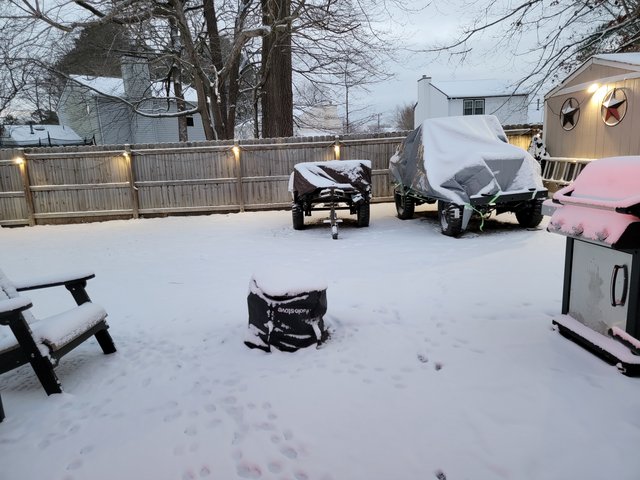

Was just out in the garage throwing another round of spray paint on the bell housing- We ended up getting about 3" of snow overnight. Don't foresee me getting much done today. I am actually running out of inside projects to do now- I wish I could have gotten that jeep inside the garage but with the void under my garage situation, until that is filled, the jeep stays outside.

The great storm of 2022.

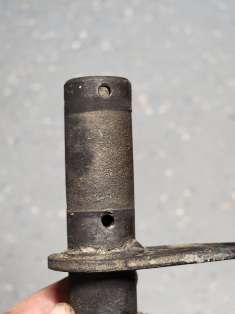

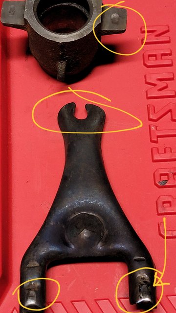

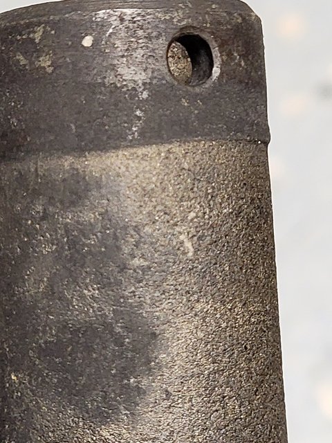

I had purchased a new throwout bearing (timken) and it came in a few days back. But I finally got around to cleaning the bearing carrier and the clutch fork.
I do not like what I see.
It is worn pretty good and the clutch fork is bent.
I had been looking for my new clutch /brake pedal shaft and can't find it. Did I order one? I have one more parts box to look in to see if I did or not. I know I have a new Z-bar.
Look at the old one and how worn it is.

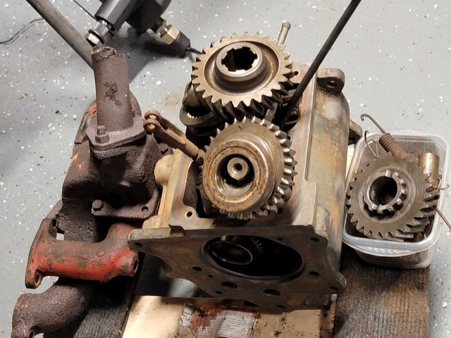

Located all the scrap metal from the past few weeks worth of work on Salty.
The intake and exhaust have some cracks, and busted ears.

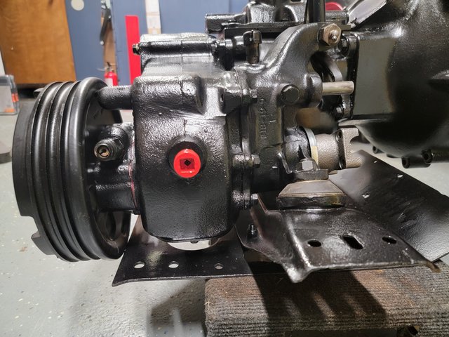

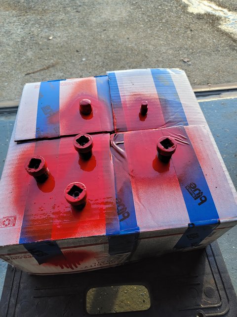

I painted the drain plugs and fill plugs of my Transmission and Transfer case RED.
No one gonna care but me.

I actually (not that you all will like this- but I do)

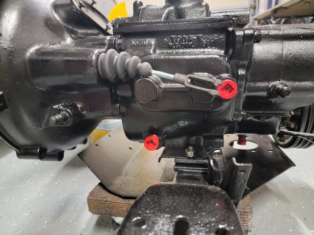

Good to go April!CoastieReid wrote:I painted the drain plugs and fill plugs of my Transmission and Transfer case RED. No one gonna care but me.
The January 1956 TM9-8012, paragraph 67.d.(2) on page 50 says "A 3/4-inch red circle should be painted around all lubricating fittings, oil can points, and refill plug holes."
RonD2 wrote:Good to go April!CoastieReid wrote:I painted the drain plugs and fill plugs of my Transmission and Transfer case RED. No one gonna care but me.Close enough for government work.

whydahdvr wrote: What's the plug in the glove box thing that the Marines did?
So I saw this on the forum a while back. Decided to do the same.
www.willysmjeeps.com/v2/modules.php?nam ... pic&t=9433
Take a plug cap, screw it into the glove box knob (inside) and then screw your bellhousing plug into that for safe keeping.
