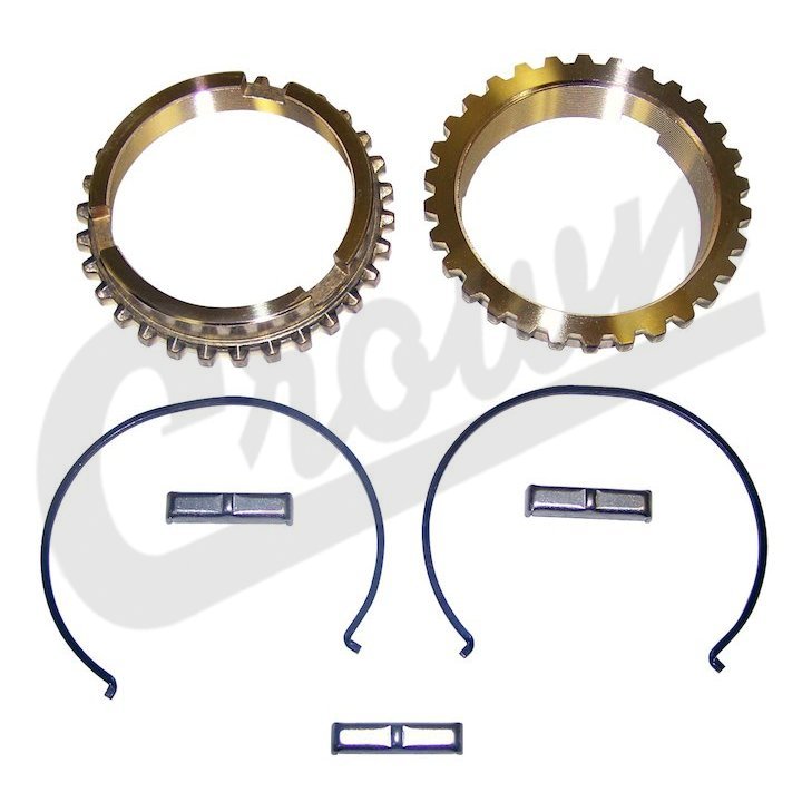

Alright, managed to tear down the tranny completely today. While my shopping list is a bit bigger than I was hoping, I believe I have confirmed what is causing most of my problems (at least one of the main factors). Most of the gears and bearings have some rust but only a few are bad enough to replace I believe. A few of the gears have what look like some bad wearing. There are two rings, I believe they are the blocking rings, that at first glance seems had some wear but its really uniform so maybe it is meant to be shaped as they are? I'm going to thrown up some photos of the stuff I need/might need to replace to see if anything else stands out to you guys.
I'm curious as to what causes this type of damage inside the transmission. My guess is that the gaskets start to fail allowing moisture to get inside. Gears and bearings start to rust allowing for premature wearing allowing more moisture and gears to start grinding away at others. But things like the rear bearing having quite a bit of rust while the front main drive gear bearing has none seems a bit odd. Maybe the jep sat for a while on a slope or do you think something else could be wrong that I am not thinking of?

If your Jeep had a missing M38 style shift boot rubber and sat outside uncovered, the shifter cane acts like a funnel and wicks water into the transmission. Or as Wes said through the vent from driving in deep streams etc. Check the inside of the cluster gear and main drive gear where all the needles run for ridges caused by wear or rust damage. Check the shafts for ridges. Measure the mainshaft where the needles up front are and where second gear bushing runs to see if it's in spec. See if the rear gear on the mainshaft has hammered the splines out. Your gears shown don't look bad at all. I'd look very hard at the drive dogs on 2nd gear, and the inside of the shift collar. If the pyramids show taper on one side, chipping, or rounding off of the tip, replace all. I'd also replace the brass blocking rings, bearings, small parts, and check the fit of the bushing inside 2nd gear on the mainshaft. You don't want it to wobble. Take a look at the case where the cluster gear thrusts fit against it. Hopefully they never spun and damaged the case. Leave nothing to doubt about 2nd gear or it will bite you. You know how much fun it is to pull the transmission so why do it again?
John
As reccomended to me. I would replace the entire synchronizer assembly
including blocking rings. All of those teeth get worn, not just the brass
rings but the teeth inside the clutch hub. One and probably a couple
more of the vendors sell the entire synchro assembly all together.
It's not that much more for that versus just a few of the parts plus you know
the heart of your tranny is all new. If you do that replace second gear as well.
You don't want worn teeth on the gear working on all new teeth in the synchro.
Just my opinion.
