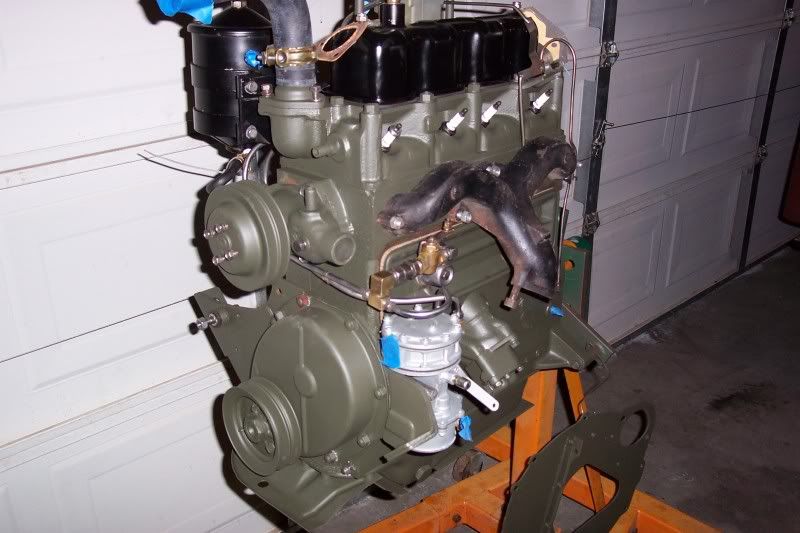

Put in a new pilot bearing. After I installed it the ID was .006 under. Didn't have a reamer but I have a lathe
so I bored it out.
Engine is not the correct block for A1 but it was a great deal and looks like it was recently gone through. Not much crud in the oil pick-up screen but took it apart and cleaned it anyway. Installed a timing gear spray nozzle with the smaller dia hole. Adjusted crank end play.
Installed engine today.
