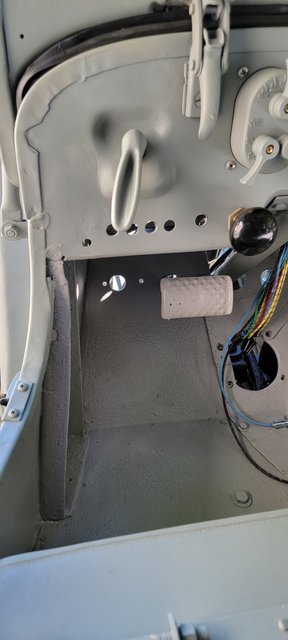

I was going to reuse the holes the previous owner drilled on the dash of this jeep. I ended up deciding not to.
I welded the holes up and drilled new holes where I want to put my accessory switches.

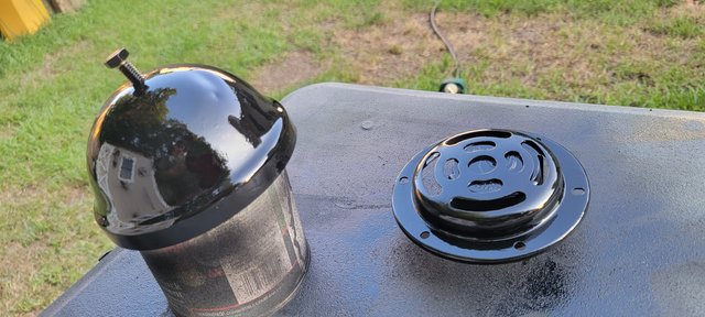

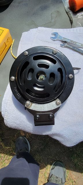

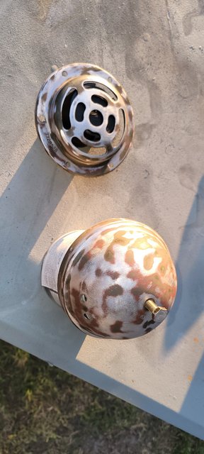

Decided since the replacement horn came in. I tore apart the 12v spartan horn housing.
Crusty inside.
Sanded the housing.
Modified a new $15.00 pancake Horn I found on amazon. I am not spending $75 on the same thing from KW. The horn is probably the exact same thing. Product photos sure do look the same, I tested it alone, then as it was modified to fit inside the Spartan housing. Sounds alright to me.
Little semi gloss paint.
If it is fully dry tomorrow, I will reassemble with new screws. Somehow I lost a stud in the grass while I was sweating away the wasp Andy swarm of mosquitoes.
