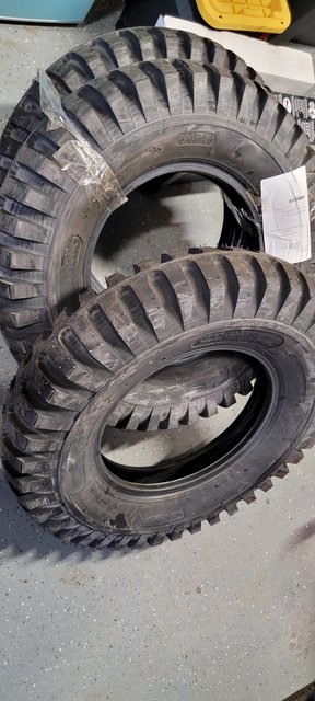

Edit- forgot to mention.... RonD- thank you for the ebay lead on the NDTs. I canceled my back orders and placed an order on ebay for three STA ndts 700-16. 1 is a spare and 2 for the m100 trailer.
Cost way more, but I'm tired of waiting. I ordered a spare in July 2021 and it kept getting punt kicked every quarter.

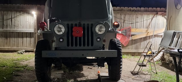

Front blackout. I will add another to the rear eventually.
Turn signals all are working.
I made the upper left the drive light, upper right bulb is brakes, lower (was the BO bulb) is my turn signal.

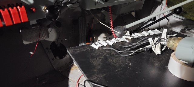

It is not that great of a picture. To determine what works were being used and when, I take the wires to a board, labeled and used my meter to see what had continuity. I flipped the switch in all the configuration and made my notes.
This is how I made sure all my functions I want to use are working.
I laid the board in the tub and used jumper wires to test, which worked. Now I know which to hook up where.
I will order some more cloth covered wire to fix that Turn signal issue I found with the harness I bought. The harness had brake and turn signal on the rear as the same. I split that, and have temp wires in place.
Ebay tires showed up in two days.
1 spare , 2 for M100.
I have time to mount them later this weekend if I get around to it.

I bought STA's.RonD2 wrote:Glad to hear you got the tires April.
I think you got the last NDT's they had.
They're Firestone aren't they?

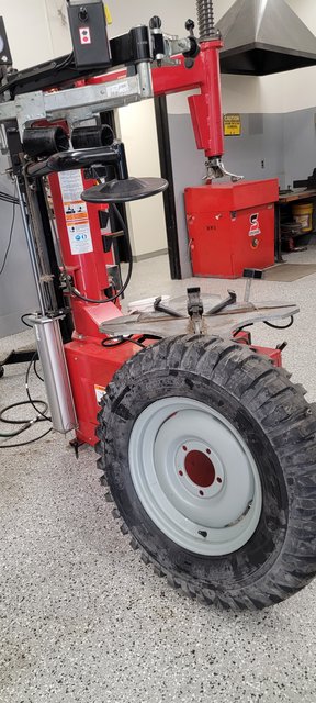

Took to base hobby shop and mounted the spare.
Took my a total of 30 minutes. Most of that looking for the lube.

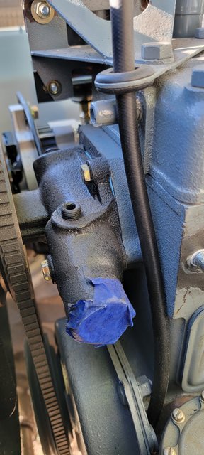

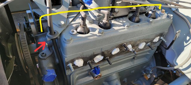

Hi April,CoastieReid wrote:...a pipe nipple on the front of the head to take off,
Not connecting the by-pass hose to the water pump?
The base hobby shop looks like you could eat off the floor...nice!
I thought all those shops were closed and gone years ago.
Bypass as in the yellow line between head and pump?
The red arrow is a cut off pipe nipple.
I don't remember but I think it was attached to the cab heater.

I think your yellow line is cab heater related as you recall. Don't know about that.
Not the same as the water pump bypass hose (maybe more properly called a thermostat bypass hose).
It's there to help the engine temp warm up more evenly by allowing some coolant flow past the thermostat on startup until the thermostat fully opens at 160-degrees.
No hot spots around the combustion hot spots. That's the idea anyway.
The ORD9 on page 11, Figure 01-1, Item B, shows it pretty well.
So does Figure 23, Item L, on page 107 of TM9-8012.
Here’s what one looks like: https://www.ebay.com/itm/182220868407
Your pipe nipple (red arrow) doesn't look cut off to me, it looks normal.
I assume this is the nipple you said you had to remove?
All you need is another like it to put in place of that hex-head pipe plug on the top of the water pump.
MWM has NOS here: https://shop.midwestmilitary.com/produc ... se-nipple/
On the M38 it belongs there.
I took the liberty of marking your photo to show where the hose connects:

Ron, I went back in old photos, it was there, you can kind of see it. You are right.
The PO had plumbing valves attached to the hoses on this engine- I wouldn't trust anything on how it was.
