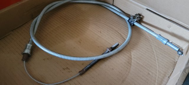

I was sent a wrong cable originally - this is one you see in video. The thread section is like 2 inches longer than the cable I just bought from Midwest military. (Which came in yesterday afternoon)
I do have those special clips installed and I added a keeper to the fender. I don't have a twisted hook that I've seen in other posts.
I also had to trim the hook and bend a new loop in it about 2 inches shorter. Otherwise even with the correct cable, it wouldn't fit.
The replacement cable has a different jacket- spiral wound wire around that sheeth.

I mistyped. The one I had was wrong -picture in box
The Midwest military one had right length but I still had to clip the hook to make this all work.
