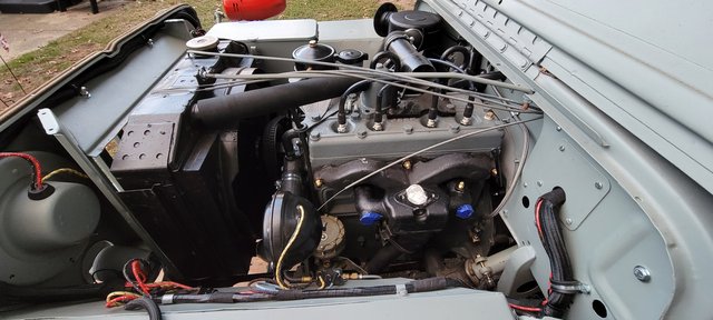

Picked up the manifold today. They said it was way out f spec and would never have sealed before.
Smart to have them take it down flat.
As for shipwrecked, I I'll do one. I did one like 5 years ago, but since it's running, I will do another. So easy to start and shift. I look forward to driving it.
So I spent time fixing that brake cable. It was two hours of my life ill never get back. That was not worth the effort.it worked the way itwas, and trying to bend that clip to fit over the cable end was an adventure of vice grip, a ball peen hammer, vice and a anvil. It now looks like hammered dog poop.
I installed the intake/exhaust manifold. Went on very nicely.
Installed my exhaust pipes and muffler. Have some touch up paint to do.
Quick fit of the coolant hoses.
Hammered the old crusty thermostat retainer out. Got one coming later this week.
Got a bunch of leave days coming up over next few weeks. Plan to finish this jeep and go for a drive.

There's more than a few posts on the vintage jeep forums, including this one, about poorly fitting exhaust pipes, mainly the long one being the culprit.
Disgruntled folks say they have to be "tweaked" to fit, with some debate over what the overall length of that pipe should be versus what vendors sell.
Did yours fit ok without a fight?
If yes, for future reference, where did you buy it?
Thanks!

I believe the problem some folks have with exhaust systems is they start at one end bolting parts down then are frustrated with alignment near the end of the run. You're spot on April.. hang it, align it, tighten it.
