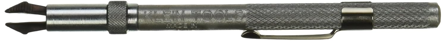

Invest in those mini gripping screw drivers.
For slotted screws
https://www.amazon.com/dp/B008C0ESJ4?psc=1
for phillips screws
https://www.amazon.com/Klein-Tools-K14- ... 1RPYDEQWTV
Slotted or phillips spring blade grippers
This one is my favorite for slotted screws:
Center, internal blade is spring loaded and controlled by the little twist knob at the top end of the driver.
http://www.tools-plus.com/ullman-d2.html

Screw drivers won't work on my terminal screw. The majority of the screw head is below the edge of the distributor.

It works on mine. there's enough sticking above the ledge to get her started with my short (4") slotted screw starter. I've done it with a small magnet as well. Also when changing points in the distributor on the jeep just loosen the terminal screw enough to slip the points up. When I need to disconnect the wire to the coil from the points for troubleshooting I will disconnect the end on the coil.
