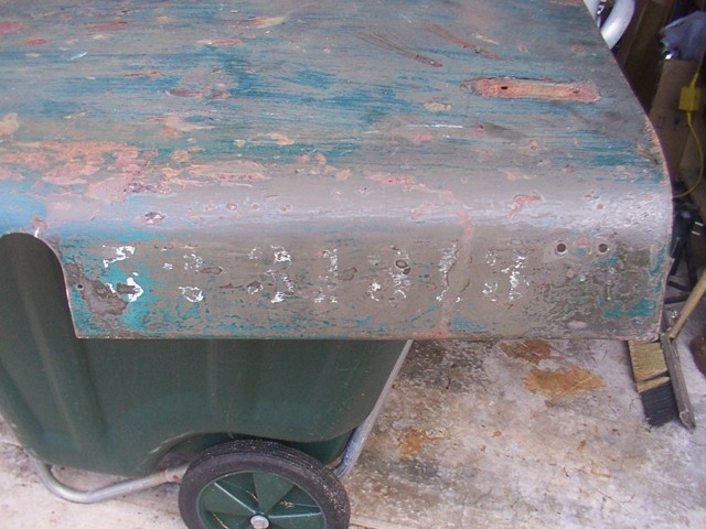

Wes,
CAR stamped on the frame is definately 52-31313. It is the number on the registration and verified by several different folks...
Also matches the hood number found on the hood...
The tool box was original in so far as I could tell... Spot welded in place and all. I have since replaced it with a repo, but I still have the remains of the box with the vent on the side and the willys script...
Hope this helps...
