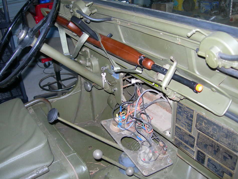

here's an easy to make tranny lock. easy to install and no holes to
drill. the hook goes around the return lip at the bottom of the dash.
it wont stop the pro thats determined to steal your truck but it'll
slow down the opportunistic punk who happens along long enough
to catch him and beat him down. :twisted:
the padlock and bracket store easily in the jockey-box when not in use.

I concur! Would you provide a bit more detail on how you made this, such as the size of metal you used there, etc?
Thanks.
The metal is plain old 1" x 1/8" flatstock. Your exact length and configuration would depend on a couple of variables: the length of
throw when the shift lever is in reverse,and the length of the shank
on the particular padlock you plan to use. In that regard i suppose
no 2 would be alike but the principal still applies.. Hope some of
you guys can use or improve on this idea..

If you look closely, there is a weld booger on the nut. My question is Rick, did you remove the splash guard or did you modify it so this could slip between it and the dash? Or maybe yours is missing.
I'd be curious how long it would take the average person to figure out how to even fire up these Jeeps. I have a hidden keyed switch that kills power to the starter circuit. I mostly put it in because I have younger kids that like to fiddle around with the Jeep and I'd hate to see them take out my garage. It won't keep a thug from throwing the tranny or the tcase in neutral and moving it that way though. I can see this being a good visual deterrent for sure.
Brett
Posts: 16466
The thief could always put the transfer in neutral and roll it up on the trailer. A short piece of cable through the steering wheel and attached to the same padlock would help a bit.

That's a great idea! What did you secure the eye loop/metal lever thing to?

It just hooks the lower lip of the dash and fastens to the stick with the padlock.

The padlock holds on both the bracket and cane at the same time. No movement can go on in either direction because the cane is as forward as it can go and the bracket is hooked on the dash and cant come off because its padlocked to the cane.

Btw, what splash guard?

There is a sheet-metal shield that protects the back side of the instrument cluster. I haven't had time to check my jeep, but I think the lock bracket would interfere with the shield.

The short apron that pertrudes from the bottom edge of the dash towards the firewall and shields the bottom of the instrument cluster from big boots.
