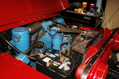

Here are a few examples of the CJV35 air cleaner from Bob W's web site:
http://www.cj3a.info/sibling/cjv35u/photos/picsv35.html
Here's a few ID vent system photos from Bob's page as well:
CJV35 vent system. Note air cleaner connections.
M38 early vent system.
M38 late vent system.

Early and late M38 used the same air cleaner. There was only a variation in the vent system plumbing.

Thanks Wes for that clarification...I really appreciate the pictures. I got to look at the air cleaner again and it is definitely an M38 air cleaner. It has the three vent line openings on the back. The large L shaped brass fitting with the double vent lines gave it away on a second look.
First time my M38 will have had a correct air cleaner in probably 20-30 years. The former owners relative was a Humvee mechanic for a rebuild facility and the M38 has been sporting parts of a military Humvee air cleaner for years. It was a novel solution that was pure military ingenuity.
I hope to get the ventilation system hooked up again as it appears to be mostly intact.

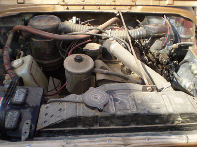

Hi Rick: I wish I had taken a picture of the engine compartment when I first found it. After I bought it but before it was picked up the seller took off the homemade fuel sytem and the air cleaner set up. All I got with it was the Humvee precleaner.
Once I get the new/old air cleaner hooked up I plan on putting the Humvee precleaner on the snorkel tube for local dirt road driving till the vehicle gets restored one day.
