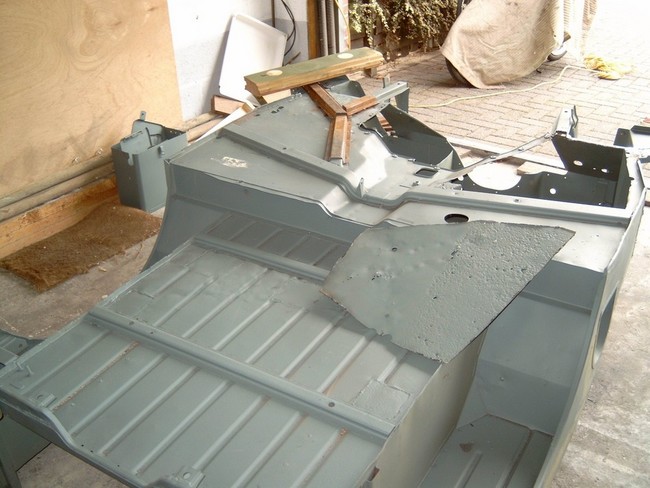

Post by maeserik »
here is a picture of my tM38 tube during repair at the bottum
you can see the hole at the drivers side, the front floorpan is cut away for replacing
Erik
