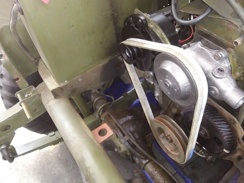

Anybody else had a problem getting a matched set of fan belts? My 24 volt alternator setup requires a pair of longer than stock belts, but my local auto parts store has yet to be able to provide me with a matched pair. So far, every pair of belts are slightly different sizes. Is there a way to buy a matched set?

Had not thought about that, McMaster Carr lists Precision-Matched V-belts in the length that I need for $14. each, thanks!Have you tried any of the industrial warehouse's like McMaster Carr or Grainger's?
Would like to, but because of the way the alternator is mounted, i need belts that are longer than the stock M38/A1 belts.Have you tried any of the military parts suppliers who support the hobby?

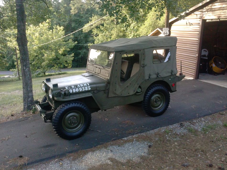

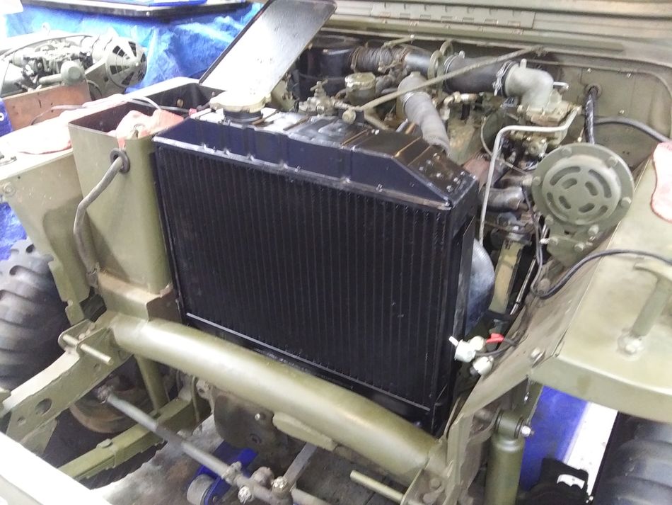

Finished the alternator install. Replaced the front crankshaft seal, water pump and had the radiator re-cored. This, along with the new springs, shocks and the brake work should make the M38 ready for the upcoming season. Also added new tires and new canvas all around.

- Posts: 16459
Looking good Chuck!
- Posts: 2071

You mean there is suppose to be a cover there? Actually, I was waiting for a new gasket and seal while I was fitting up the belts. You will also see that I had not yet installed the bypass hose and all the water pump bolts and mounting gasket, either!
