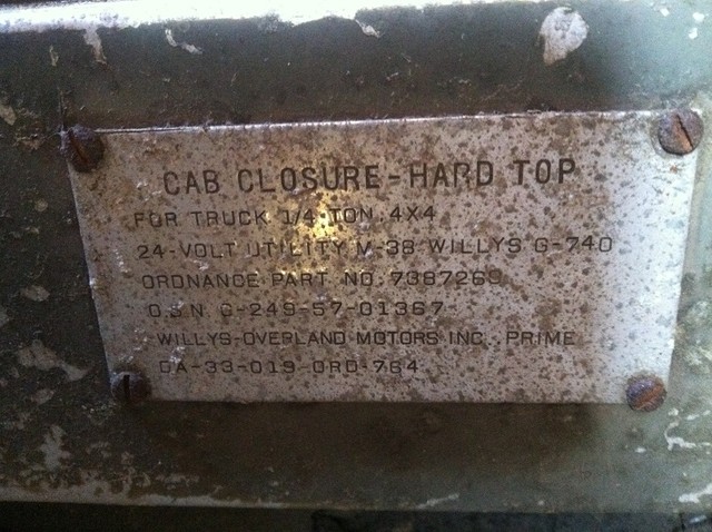

It's an M38 Hartop enclosure kit. It was an early design for post WWII jeeps MB & M38:
Here's a later issue:
