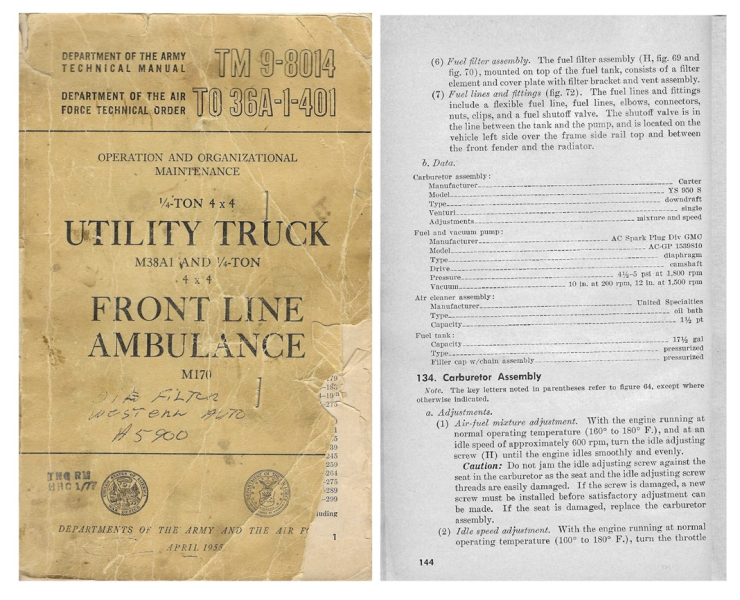

Re: M38A1 fuel pump vacuum pressure
In TM 9-8014 page page 144 all the fuel system specs for the M38A1. Just about all systems on MV's have theses listed in their operator's handbook.
[image]https://www.willysmjeeps.com/app.php/ga ... 619/medium[/image]
