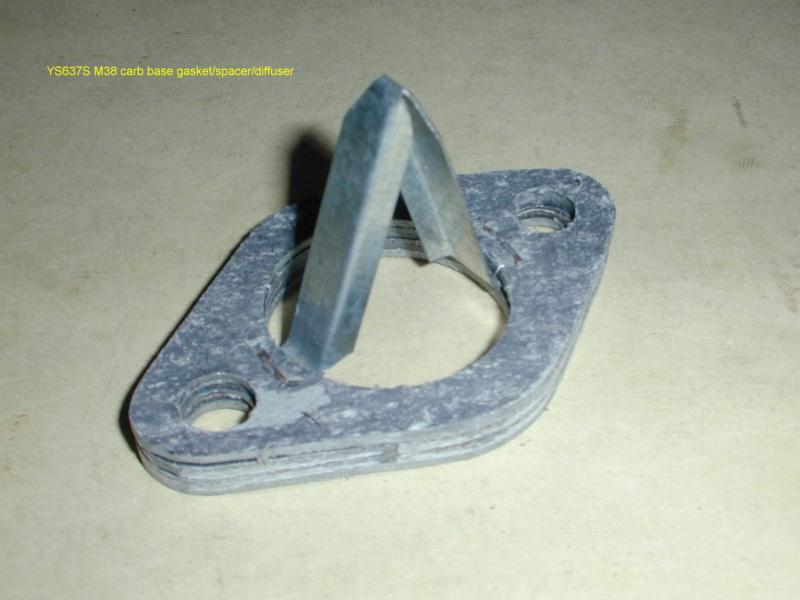

Just to conclude this post, the problem was the carb was rebuilt incorrectly by TWO shops. I took it apart and discovered the one of the diaphragm springs was too long. I installed the short spring as indicated in Wes' Photo album and it starts right up and no stalling, at least so far anyway. Thanks for the replies.
- Posts: 16473
Re: Engine cuts off
Glad you found that being told something is new or rebuilt does not mean that it is free of any deformities or malfunctioning parts and there is no guarantee that anything you pay to have rebuilt will for sure be rebuilt correctly.
Did you also make sure the spring on the opposite diaphragm was installed between the diaphragm and the cover? The Carb overhaul manual that owners and repair shops should be using Army TM 9-1826A dated 1952 have an error in the assembly illustration Figure 60 pages 114-115, that was never corrected.
Another thing that is often not in place is this special carb base flange gasket

3. Next step is to accurately assess float level setting and actual fuel level in the bowl by opening the carb up.
Have you done this yet?
Yes. Float level is 1/4” measured with a drill bit, from bowl bare metal to center of float.
4. Did you also make sure the spring on the opposite diaphragm was installed between the diaphragm and the cover?
Yes. Spring is installed correctly. Carb has two thin gaskets and special diffuser base V gasket between them.
