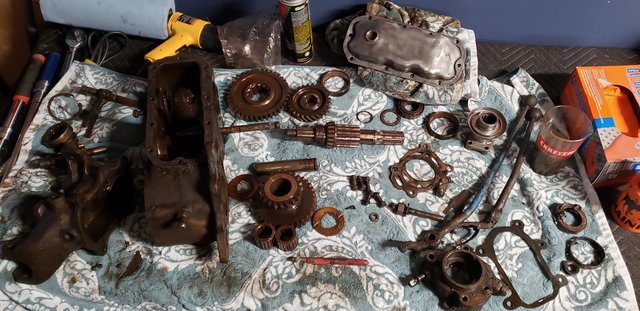

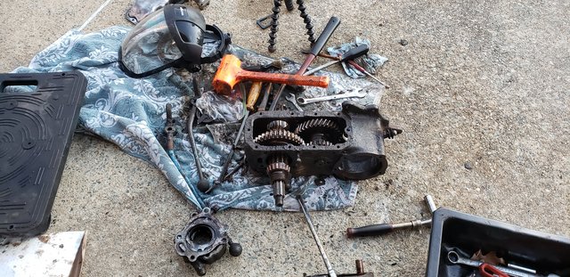

I took apart the D18.
Disassembled
I put the case in the parks washer after I scraped all the crud out that I could.
I have duty on the ship tomorrow so it will just have to soak till Sunday,

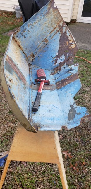

Put in place to help me work the fenders

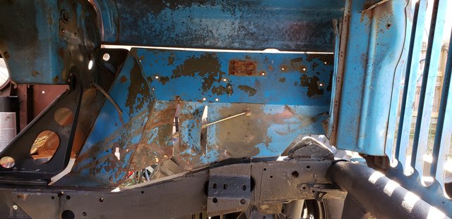

Inside the driver side was super wrinkled.
I used a hammer and dolly a bit to straighten it out, but it still needs a lot of work.
A lot of metal will need to be cropped and patched.

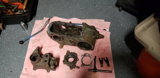

I did spend a few hours at the parts washer scrubbing the D18 housing
There is still a nook and cranny here and there with the road grime cemented in. I may need a pick and some more break clean for that.
All the pieces are on hand, I just need time to do the assembly. Will paint it after assembly is done.

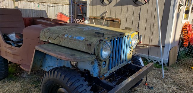

anyway, today i did some front fender work.
The fenders are only on there by 3 bolts. the supports are not welded in yet. I had to make sure i was lining them up correctly.
