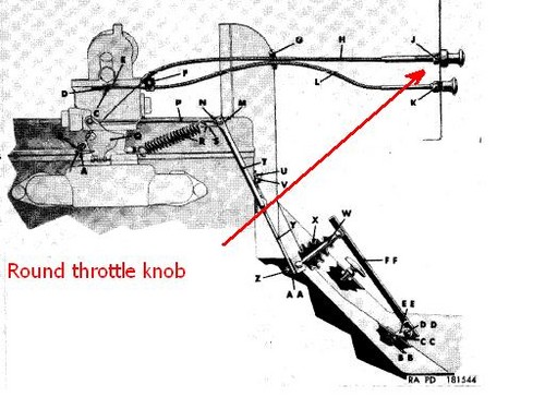

There are two definitley rounds knobs in the pic.
My M38 has a crome Tee handle for the throttle. and a black round knob painted OD for the choke. So I was just wanting to know what might be correct if I should decide to replace them.

I agree with Greg. OD round knob with the appropriate name in white letters
Posts: 16461
The "T" handle throttle was introduced in the M38A1 and was most likely the only cable stocked by the Army for both jeeps after the mid 50's.

I loaned my A1 manuals to a friend and never saw them again so, I have 1 left Tm9 2320-208-20P dated '66 and it shows a T handle throttle with horizonal lettering.
I also have a N.O.S. T handel throttle assembly labled G740-73-75115 that is verticaly lettered packed 3-56
Posts: 16461
Ken,
Did you personally open the sealed container? Or was the cable already removed from it's original packaging? That is the original M38 ORD number for the throttle control yet NO photos of the M38 dash in any manual show anything but a round knob. The only "T" handle control shown in any M38 manual is the Fording valve control. Perhaps you can post a photo of the control and it's packaging? The M38A1 ORD lists an entirely different ORD number. I would think money concious supply folks would have used the same control for both jeeps. Length differences would have been very minor.
