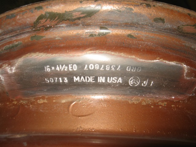

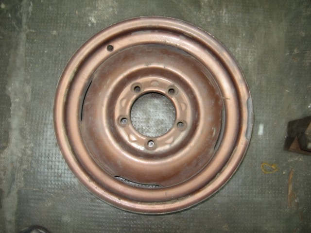

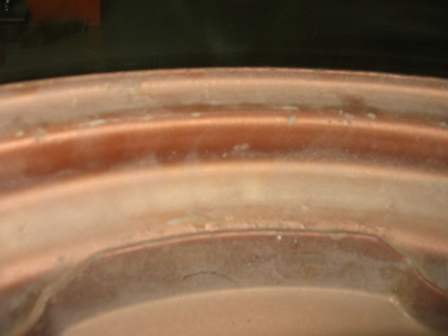

Two types of Rims arrived at Argentina with the M38A1 and M606. One it known by you (that of the small hole) and the other is the one that can see in the album.know this model of rim, in which other vehicles places.greetings
You can see in Photo Gallery Member Album Luis
Dos tipos de llanta llegaron a Argentina con los M38A1 y M606. Una es la conocida por ustedes(la del pequeño agujero) y la otra es la que pueden ver en el album.Conocen este modelo de llanta,en que otros vehiculos puede haber sido colocada.Saludos
La puedes ver en Galeria de Fotos Album miembro Luis

Luis,
The rim you have pictures of looks very similar to the M38A1 rim, but I am not sure that it has the saftey bead.
Many civilian rims did not have the saftey bead.
I do not know about the wheels issued to the M606, but it would not suprise me if that rim is from an M606.
I noticed it has an ORD number. That should make it easier to trace back to its original application.
Do you have the parts manual for the M606? Someone here should have one.

Thanks by the answer Ryan.
The Argentine soldiers mixed all the rims and we do not have the certainty of which goes in each Jeep.
The rim of the small hole has the logo KelseyHayes and the date **/62. All the M38a1 are of the year 62 and they have correlative series number.
Different happens with the M606. They arrived in departures separated during the years 1965 / 1966 /1967 / 1968
Saludos
Luis
Saludos
Luis
