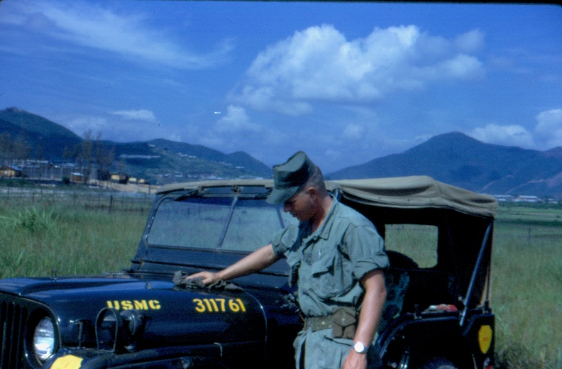

The hood # from my dad's in Vietnam is 311761.
Here are some pics of the USMC markings on his Jeep:
Thanks,
Dave

Man, that's a CO's rig. Look at that shine!

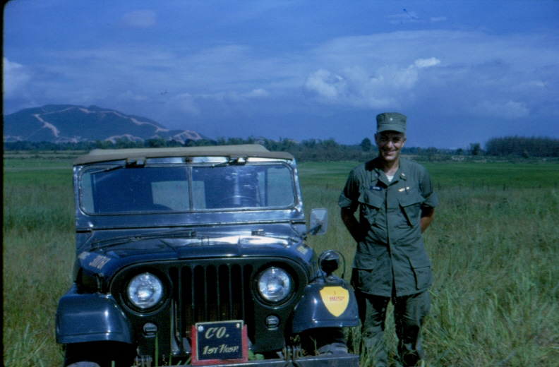

Thanks, Wes, that's good to know. About the shine on that Jeep, my dad said his driver spent all his free time shining that Jeep. The order came down to replace it with an M151 and the driver (Gary Fox) asked to keep the M38A1. My dad wrote letters that this was a good Jeep and they should keep it, but no dice. It may still be in country. It will live again when I finish my project.
My dad was CO of first Hospital Company in DaNang. He was Col. Potter from MASH. When I was in high school and MASH came on my dad would leave the room. Guess it brought back too many memories. I've got all his pictures to display with the Jeep. I've heard they used to rub them down with diesel fuel. I will re-create the signs also.

It was common military practice to make the flat & semi-gloss finished jeeps shine by rubbing them down with various petroleum products for parades and etc. In the case of Dave's dad's jeep since he was company CO it was common for those jeeps to get a full gloss paint job.
