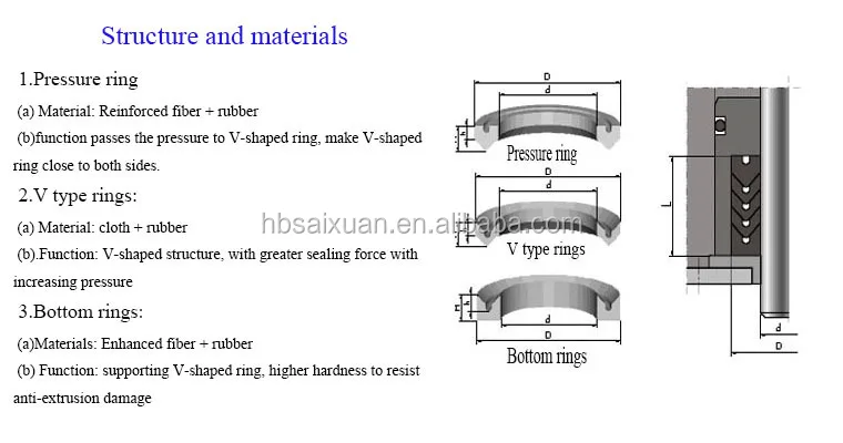

O-rings are generally manufactured to very close tolerances and prefer a shielded mounting environment that supports the O-ring in all directions. O-rings prefer tight chambers and groove mounting. The best way to mount an O-ring at the tip is in a groove so you would need to fabricate a short cylindrical spacer that will fit the threaded cup end and place a groove in it of the appropriate depth and width to adequately support the O-ring type and size you wish to us. That O-ring should be sized with an outer diameter that allows an interference fit inside the barrel, an inner diameter that allows an interference fit on the 3/16" threaded stub and a thickness that fills 99% of the groove.
I would suggest taking a look at Chevron type seals (V-packings) instead of O-rings for the 4 packings.
Here's an example in sizing:
V0037500625FF VP. 0.375 X 0.625 FEMALE V.PACKING - NEOFAB Details...
V0037500625FM VP. 0.375 X 0.625 MALE V.PACKING - NEOFAB Details...
V0037500625FV VP. 0.375 X 0.625 C.RING V.PACKING - NEOFAB Details...
You can view these at:
http://www.sealsourceinc.com/website/ca ... ing%203/16
They cost $2.93 each.
