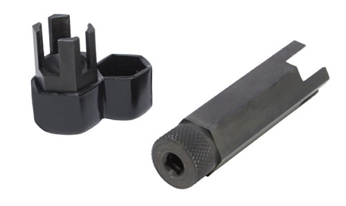

Must have big arms. I have never had any problem reaching and turning it. I can offer up a special tool you can make and use.

Or you can spend more tool money!!
Camco petcock tool
Lisle petcock tool set
https://www.amazon.com/Lisle-60450-Radi ... B00B01H5E2
Thexton THE485 Petcock Socket Set
https://www.amazon.com/Thexton-THE485-P ... B000OCKJJG
Camco petcock tool
