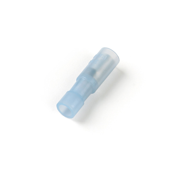

You'll need a booted style male terminal pin.
Similar to this.
However if the second photo is your switch with half an ear broken off you may just need to solder the pins in and insulate with heat shrink.
