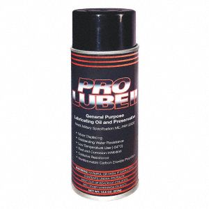

- Posts: 16447
Look harder Ron!
http://www.willysmjeeps.com/v2/modules. ... ly&t=13185
___________________________________________________________
The real problem with your 30 Wt engine oil suggestion is it's viscosity. It is way too heavy/thick. Especially in colder weather.
Military Standard MIL-PRF-32033A Type I Class 2
General Purpose Lubricants
General purpose lubricants reduce friction and wear, and prevent machinery from overheating. These fluids leave a slippery coating on two surfaces to keep moving parts like wheels, hinges, and gears moving smoothly and extend the life of equipment. Lubricants also provide some protection against water damage, contaminants, and corrosives.
Search
Container Size 12 oz
Lubricant Container Aerosol Can
Lubricant Base Petroleum Distillates
Primary Additive No Additives
NSF Rating Not Rated
Item # 5MN59
Price $14.03 / each
Ability One
The definition here would be a troop halfway between a bone head & a rocket scientist.I still wonder what the average soldier back in the 1952 motor pool would use?
