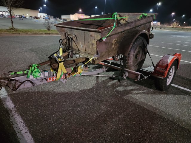

This is what I did:
U-Haul car dolly. Cheaper than any of their trailers, especially if you play around with the pick-up location somewhere in between where you load it and home seems to be cheaper rates.
U-Haul wants to know in their on-line reservation system what you're hauling but has no provision for a "trailer on a dolly", so I just picked that I was hauling a Willys CJ3A and it went through. Nobody at their store asked me what I was hauling, and I didn't volunteer it. I hauled mine from Maryland to South Carolina with no problem at all. Hardly knew it was there behind my 2003 Tacoma 4x4 and 4-banger motor that has a 3500 pound bumper hitch. It's a safe load to haul.
The M100 weighs less than 600 pounds so the dolly has plenty of capacity for it. Note my block of wood under the M100 tongue and some ratchet straps to secure the M100 tongue to the dolly tongue worked well for me. The dolly has wheel straps and chains for securing the axle. I think the dolly needs a 2-inch ball, but recommend you confirm that.
The dolly has ramps, but you'll need help loading. It's not a one-person job. Two can do it. It's a little awkward getting the M100 tongue up to the dolly tongue (one person stepping through the dolly frame while pulling the M100 tongue, while the other person pushes the M100 from the rear).

No squirrel problems at all. It tracked straight and true, and I was doing 65 on the interstate most of the way.
The gentleman who sold me mine helped me load it. As long as the wheels aren't frozen it's easy to move around by lifting the tongue (about 60 pounds). The hard part is getting it up the ramp at the same time. I hope you can get some help.
I'll take a photo of the block of wood I used under the tongue. It's 4"x4" about a foot long. Use your circular saw to cut a 3/4" slot about 2 inches deep for the casting on the M100 folded landing leg to rest in (you'll see it), then strap it down tight. Very solid.
You won't have any problem with your F150. You might only see the dolly fenders in your rear-view mirrors.

4 by 4 a foot long. Set saw depth about 1.5 to 2 inches and make about 4 plunge cuts (chisel out the debris) to get 3/4-inch wide semi-circular slot.
I also use the block when stowing the M100 in the garage tongue down.
If you find a convenient on-the-route pickup location within about 50 miles of the M100 you won't have to haul it empty very far. Some locations seem to offer better rates than others. I recall I paid about $75 to rent the dolly whole trip (one long day).

Well I did it, at first it was a bit scetchy with the washboard narrow rads.
The straps on the body tub crisscrossed are to keep a new bed floor in there for my peace of mind.
Loaded pretty easy with two people. One to push and one to lift the tongue. The 4x4 I had was too long and didn’t sit right on the dolly tongue. Thankfully I put two eye bolts in it so I could strap the heck out of it. Next time I’d make it a 4x6 about 8” long.
This tub is rough. Pretty sure I can handle it though.
Future me problems.
Drive was a little white knuckle over a bridge in MD nearby Dalgrem Naval base. Narrow bridge, at night, windy and semi trucks over the center line. Minimum speed on it is 40 with max 55. I went over it at 35.
Those Auto Dolly’s are loud when empty. Otherwise I only knew it was there when the washboard road made me very aware.

The trailer I used compared to yours was that this one was newer and had a brake on it. which made using a 4x4 like you mentioned and I made very difficult. The brake mechanism is in the way. I had to put it on there sorta cockeyed.
