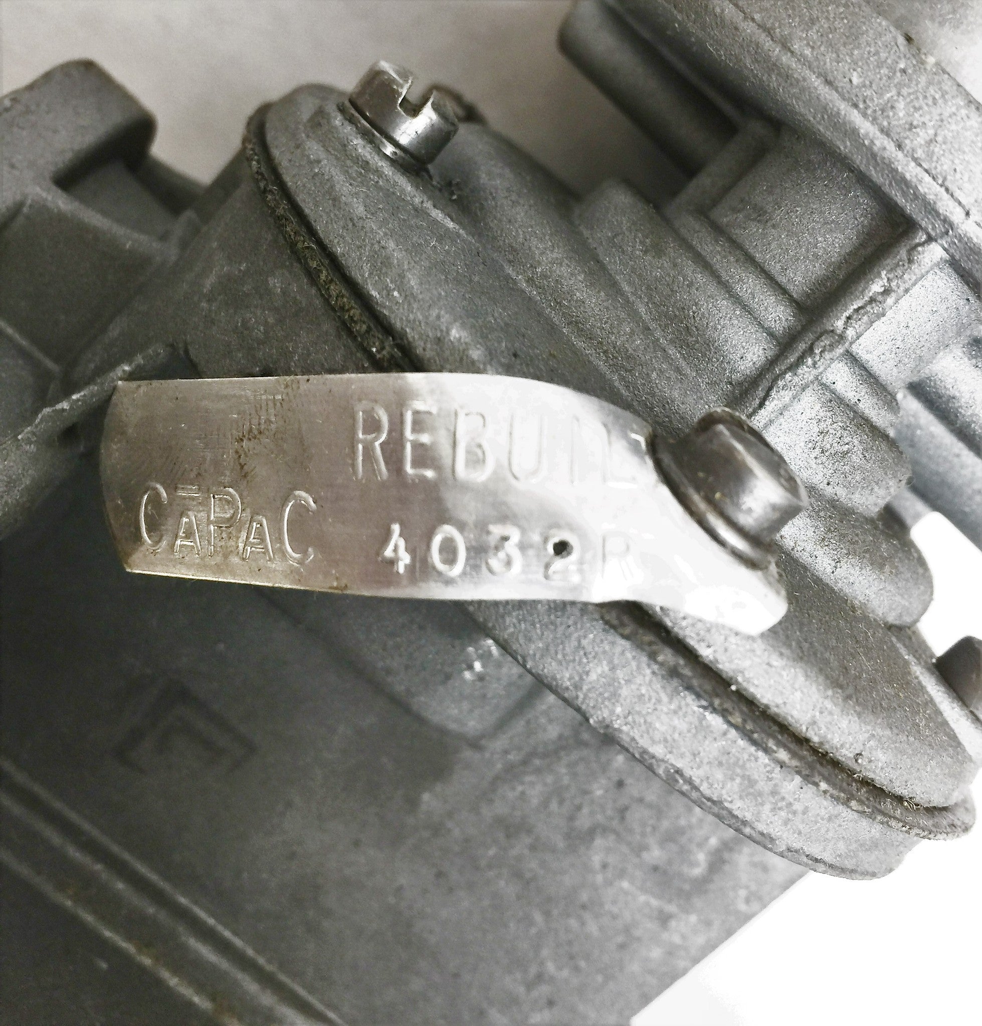

Technically this is a CJ3B jeep question but I am rebuilding the F134 engine and I don't have a fuel pump.
I see originals with dual action and glass sediment bulb on top for sale on ebay for $100 - they say rebuildable and looks in good shape and then buy a rebuild kit for $45.00
https://www.ebay.com/itm/176302908967
Or go with new aftermarket from KaiserWillys for $100
https://www.kaiserwillys.com/products/n ... gJdbPD_BwE

If you would like to keep an original theme with your rebuild, go with the correct fuel pump and rebuild it. If you should find an NOS fuel pumps they should be rebuilt as their diaphragms will not stand up to todays fuels. Check your parts manual as I believe you will also need the 1/8 inch thick spacer to install it correctly.

I followed your link to the fuel pump and I do not believe it is the correct / original fuel pump for your engine. I believe AC 4698 or 9562 would be the fuel pump you would want for the original look. There is an AC 4692 for $40 on ebay along with several AC 9562 fuel pumps including an NOS one. To me, they both look alike and I have several of each.

- Posts: 16474
Glass bowel on top is correct.
The early Service Manual SM1002R5 and the late SM1046 Both list AC 5594032 however the SM1046 also lists the Carter 21955
Found this 4032 NOS reman for $79 at: https://governmenttransitsurplus.com/pr ... 1645573492[/img]
What year is your 3B. I have the early 1956 edition of the parts list as well as the late 1962 edition.
