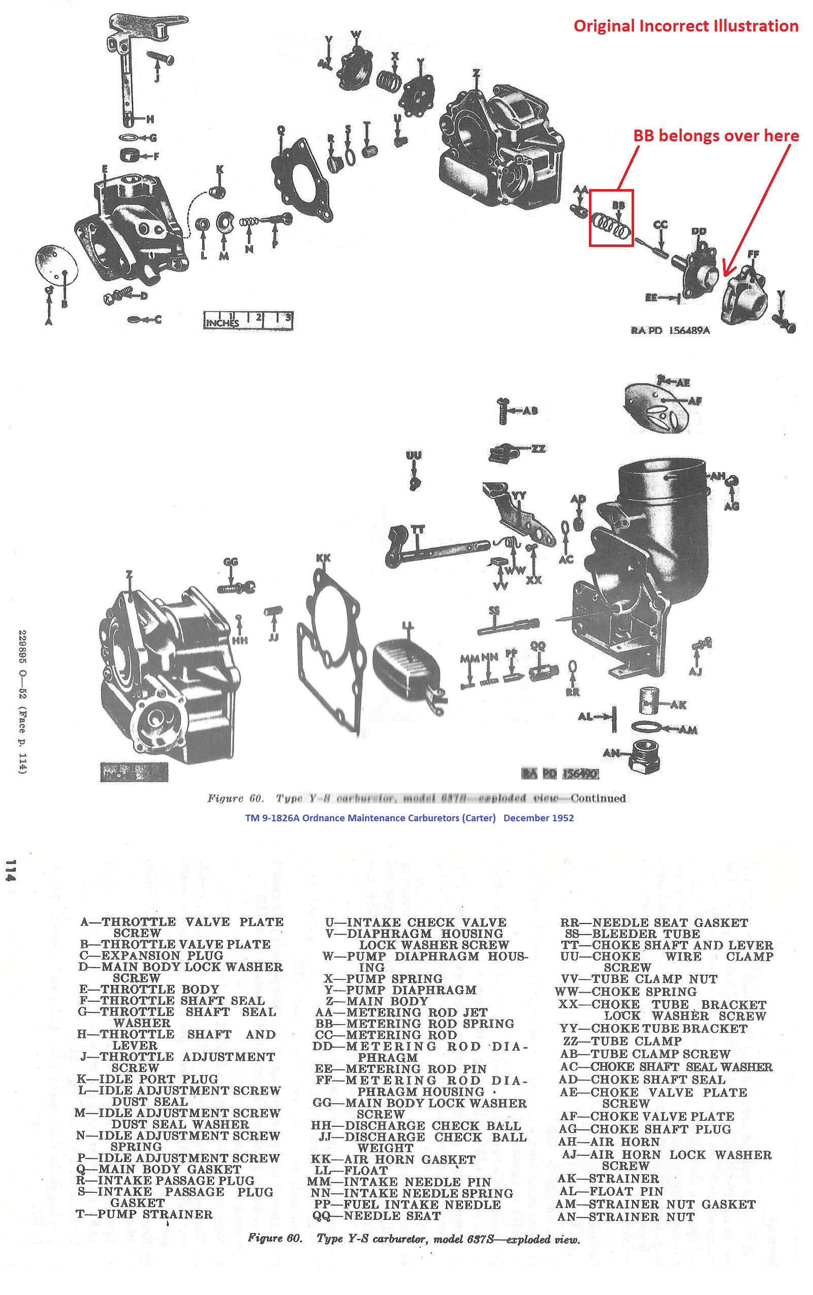

Posted: Fri Jun 19, 2026 7:56 pm
by lilm38
Just to conclude this post, the problem was the carb was rebuilt incorrectly by TWO shops. I took it apart and discovered the one of the diaphragm springs was too long. I installed the short spring as indicated in Wes' Photo album and it starts right up and no stalling, at least so far anyway. Thanks for the replies.

Glad you found that being told something is new or rebuilt does not mean that it is free of any deformities or malfunctioning parts and there is no guarantee that anything you pay to have rebuilt will for sure be rebuilt correctly.
Did you also make sure the spring on the opposite diaphragm was installed between the diaphragm and the cover? The Carb overhaul manual that owners and repair shops should be using Army TM 9-1826A dated 1952 have an error in the assembly illustration Figure 60 pages 114-115, that was never corrected.
Another thing that is often not in place is this special carb base flange gasket
