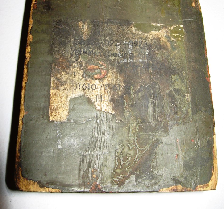

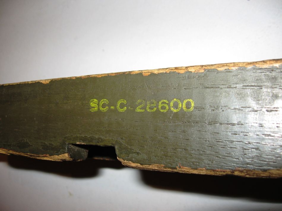

Original Spacer SC-C-28600
- Luis
- Posts: 123
- Joined: Mon Mar 27, 2006 6:00 pm
- Location: Buenos Aires,Argentina
SPACER SC-C-28600
Mariano Paz
1966 Kaiser M606
1945 Willys MB
1952 M100

It is a wooden spacer used to provide a level surface for a radio mount when the original steel mounting area was not flat and smooth. I have Signal Corp drawings for SC-C-28599 and SC-c-28602 but I do not have the drawings for SC-C-28600 and SC-C-28601.
