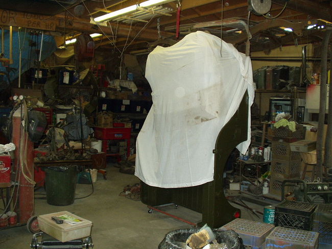

I have no issues with fabricating, I seem to do it almost every night in the shop.
A few of the itmes fabricated in my shop:
The tie down "D" rings will be a snap, actually I think it is 3/16ths.
Thanks for all the info, it is a good day when you learn something new.
Pat
Pat
