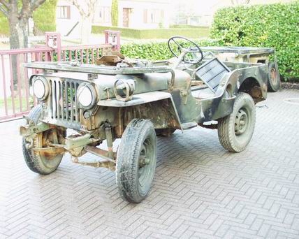

Before prevouis owner dismantled my jeep, the one i restored i think there were mutt wheels at the back....Image
possible they fit at the rear axle not at the front axle ?

The center hole of the 151 wheel is too small for the front hubs. The wheel offset also causes interference issues with the fenders.
